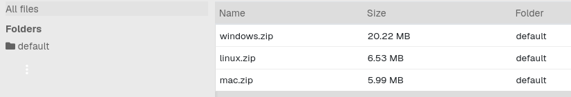

Open the "ERP Printer software" option and its file manager. The file manager should contain 3 separate operating-system-named archives. Download the archive for your computer's operating system and extract it to a "safe" location.

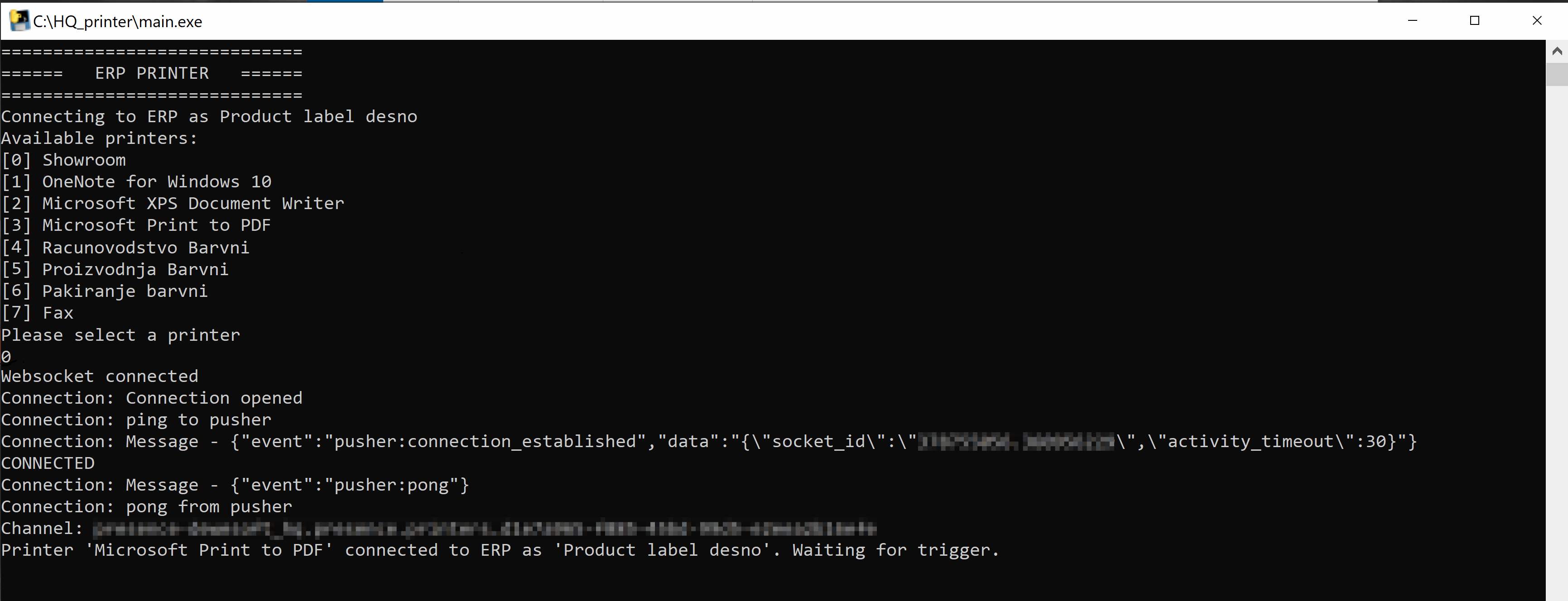

Once all this information has been defined, you can perform a test run by opening the "ERP Printer" file. If all information has been correctly entered, you should get the following notification:
Printer 'Your-selected-printer' connected to ERP as 'Your-Printer-Name-In-ERP'. Waiting for trigger.

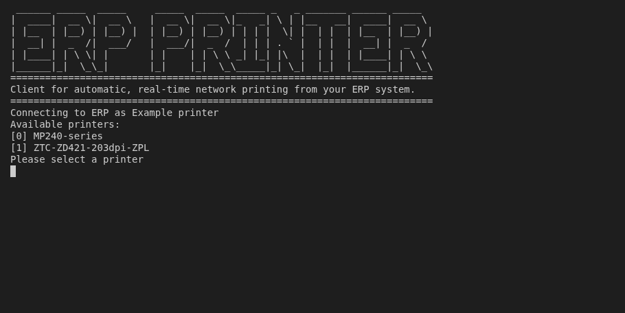

Once the authentication information has been entered, save the .env file and start the "ERP Printer" application. After a successful connection to the ERP, a notification will appear:

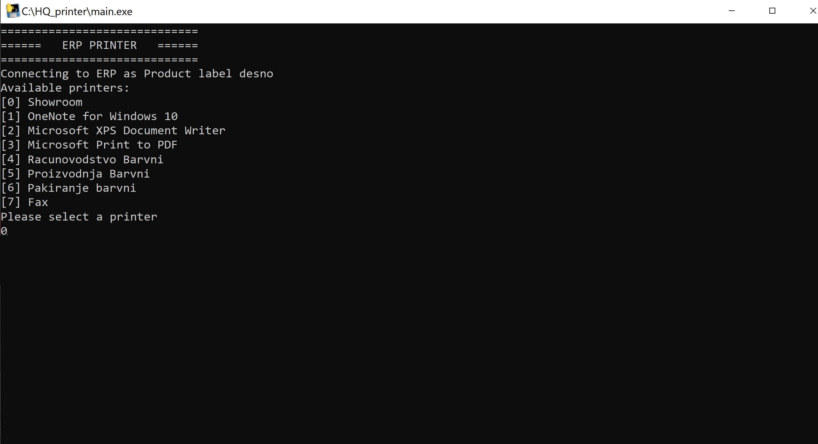

Once you find your printer on the list, enter its corresponding number (e.g. 0) when prompted. This will select the printer (e.g. Showroom) and connect to it. A successful connection attempt will generate a "Websocket connected" response, like on the image below.

One started, the printing software will always prompt you to select a printer, to which it should connect and send printing jobs.
You can edit the environment file so that the "Available printers" selection gets skipped and a select printer is chosen automatically.  To do this, copy the printer's name from the list and add it in the following line in the environment (.env) file, then save it.
